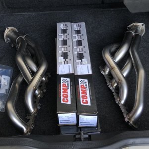

    I’m just throwing the cams in right now to get them out of the way. Hoping to get the headers in by the end of the month since I’m still undecided on the exhaust(muffler, bend angles, my absolute inability to weld etc lol).

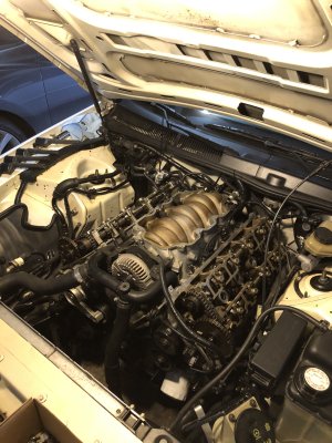

    @XR7-4.6 what you got going on?? Looks dope. Your running coil packs??

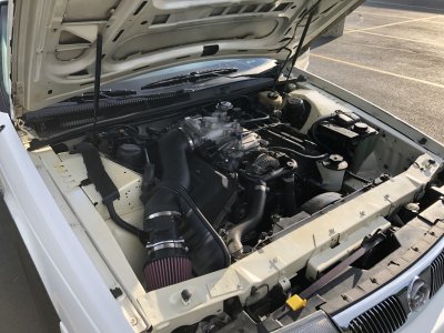

    Coil packs are stock, those are COPs. Yeah been running them since back when I had a PI swap. Here’s how it looks normally;
    As for what I’m doing, throwing in my ludicrously expensive cams lol

    They weren’t quite that much… $1,600 …Headers were a bargain at least at $1,000ish lol those aren’t on yet but should be by May.
    It’s a 97 Tbird computer with the coils in series. I’m a NA guy so spark blowout under boost isn’t a concern. I’ve got it wired to go to true COP with a later model PCM with a few tweaks inside the harness as well though, there’s just not enough motivation to find a newer PCM and change SCT databases for now
