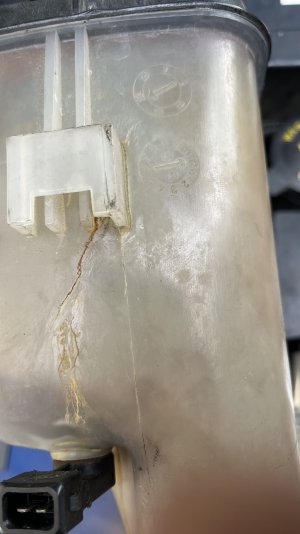

My daughter’s done with school this week so I’m stealing her car and will pull out the overflow tank to inspect it better. I did confirm it’s leaking aground the level sensor, but can’t see in there without removal.
Removed the tank, theres a few cracks in the side just above the level sensor electrical connector. You can see some of the crack in the pic below and the trail of leakage.
I cleaned & scuffed the plastic then put a good coat of 2 part plastic epoxy over it; ain't the prettiest fix, but hopefully it holds till I can find a replacement. It appears the only option is junk yard.

Well that didn't hold at all. I installed it today, filled the coolant then pressurized with the loan a tool... It's peeing. :(
I'm assuming there are no other options than used junk yard at this point? In searching I found really nice polished aluminum overflow tanks, but none for our cars.
Does Dorman make one? thats my only thought, or ones from other cars that are the exact same, maybe find the part number and then google it and see what other cars pop up that it says its for.
That’s what I found with Google, suck.
I ordered one off ford parts giant in '17; I went to order another one a week later, and no more stock. :(
The only way to seal it would be from the inside, because nothing sticks to that plastic.
I figured this epoxy would at least not hold for long. I don’t see a good way to seal from the inside. Although as I type I remember as a kid we had a motor home with 3 gas tanks, even at those gas prices most of the time those tanks were empty and developed rust. We found some liquid to line the inside, basically dump it in roll the tank around and let is cure. Maybe there is something like that out there?
Flex Seal tape maybe? I heard it sticks good to almost anything. Buddy of mine at the City Transit garage says they use it and you better be sure what you wanna stick it to cause once it's on, it's not coming off without a fight. Might be worth trying... And it's available in clear.
I doubt any epoxy or tape or anything will hold because it is under pressure. The only thing that might work is a plastic welder, but I’m not sure what type of plastic that is, so I can’t say whether that is viable or not.

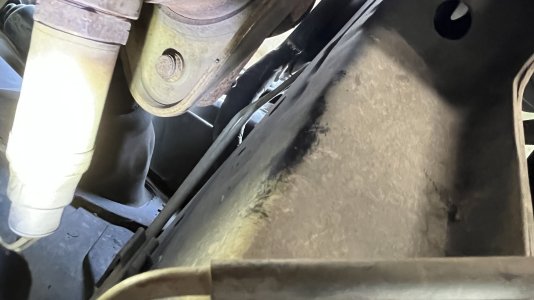

Back to fuel trims, I changed the oil today and took a good look at the exhaust finding a bolt broken. Could this be the cause? I don’t heart an exhaust leak and the other bolts are tight.
If you're talking about the bolt on the flange that's not broken. The flange is threaded for it.
The other 3 bolts have nuts, is this one different and tightens from the top?
The code is on both banks .. so one loose exhaust pipe will not affect both. No.
That’s what I thought also, is gotta be something common to both banks.
