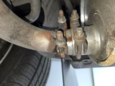

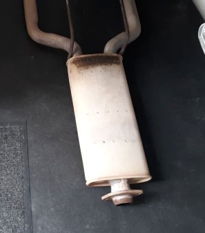

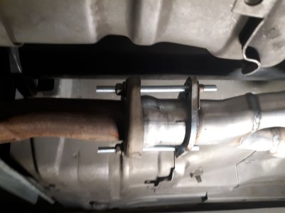

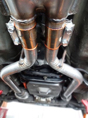

    LMAO... let me find some pics... CAT forward is fine, CAT back is from a V8 Cougar and the mufflers input are not 2.25" OEM size (2.5"), as suggested in the advertisement when I bought them. The CAT forward to CAT back is 2.0" to 2.25". I think its a mess and I believe is part of my rattle when the car is cold. Once I drive around for 5 minutes or so, the rattle goes away. I am thinking the exhaust tubing is swelling with the heat and sealing up any loose areas that might rattle when cold. I thought about taking the car to a mechanic and see if they can find the rattles, but the last time I drove with a mechanic, they said "what rattles? I don't hear any rattles...". That was the end of thinking someone else might know what it is.

    Ah, I see. Ok, so in your case I would get the 2.25” dual kit from truebendz, a Magnaflow 2.25” dual inlet/outlet muffler with the built-in X-pipe, and a pair of 2.25” Dynomax turbo mufflers. The setup then would be your front pipe sections, into the Magnaflow mid-mounted, then out of the mid-mount to the trubendz pipes, out yo the back and then into the turbo mufflers, and have it all welded together, not clamped! If you want to make it easier to remove for service, you can add a pair of flanges right in front of or behind the mid-mount muffler, but again those should be welded in place. That setup should keep it pretty quiet, not drone, and resolve your exhaust rattles.

    Interesting phrase. :P Duly noted. The only reason I got the V8 exhaust from a cougar is because I now have dual pipes in the back. It looks so much better than one muffler. I just need to take care of the rattles under the car and I suspect it is the clamped joints I have. As mentioned, I think for now I will get the joints welded (or learn to weld) and be done with it. The exhaust itself is in good condition, but the joints are a joke. Thanks Grog for the input, always welcomed.

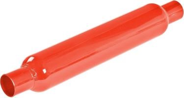

    How similar would these glass packs be to a central resonator on my car (using 2)? Night and day or mildly different?

    Are you using a crossover pipe(x/H)? You certainly COULD use cherry bombs as resonators but I don’t see those fitting with a crossover pipe in the limited area you can place them, a DIDO magnaflow style straight through muffler would be a better bet since they have a built in x pipe.

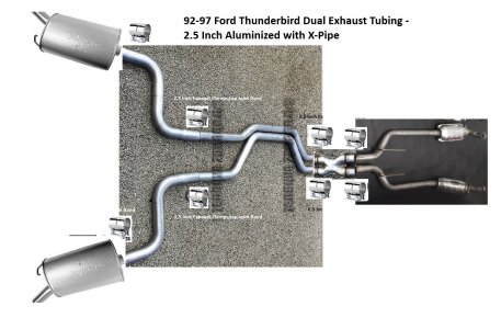

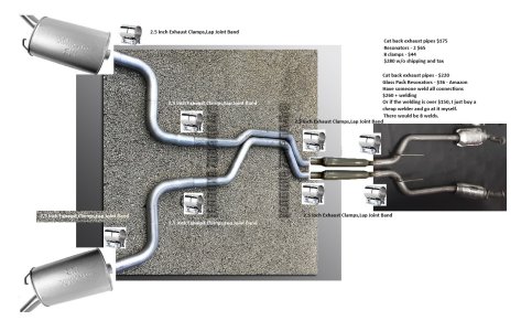

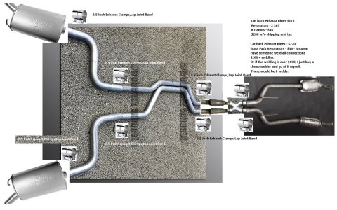

    Here are 2 layouts I am considering:
    (I do want to either weld the pipes myself or have someone weld them, the clamps are there to hold it in place under the car to fit weld the parts.)

    Yes, V6 or V8 doesn’t really matter, a crossover helps, you get better scavenging, more performance and better sound than straight pipes. If anything it matters more on a less powerful engine since you get more out of things like this.
    I'd probably go with a magnaflow cross flow resonator, which is basically an X inside the muffler. Had a cat back on my 3.6l Malibu that sounded really nice. But really thinking the benefit for you is one piece that does everything you want or need there.
