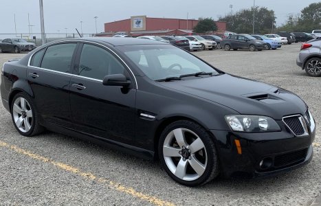

Back in my Pontiac days I had to install a Borla cat-back system to get the drone to say goodbye. Now, that WAS a 6.0 liter L76 that was over 350 HP stock in a 2009 G8 GT.What is the reason for replacing the exhaust? If you are looking for a good sound, you pretty much aren’t going to get that out of the 3.8. They just are not a good sounding engine, and with larger exhaust they tend to drone at highway speeds. If you are looking for performance, your money is better spent elsewhere as the 3.8NA will never be a powerhouse, and you would need to be making significantly more power before the stock exhaust really becomes a restriction. If you just want the look of the dual pipes, get a stock rear section off a V8 car in the junkyard, it will bolt right up to the stock front section on your V6.
