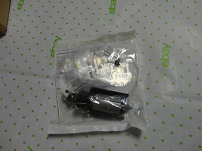

Dorman at one time made an ignition cylinder that had this ability. It came with everything to easily repin it to the original key. It was a nice option but has long been discontinued. It was the same part number as the one they sell now, they just changed it to the standard replacement type.
It may be possible to still find old stock on eBay. I bought one about 6 years ago
Interesting. Thank you for the follow up.
As long as the picture in the listing is accurate this is one of the old stock Dormin kits. You can see the extra parts in the picture that are used to rekey it

I ordered the cylinder from the eBay link I posted earlier. Lucked out and it is actually a new old stock model! I don't need it right now but it's good to have a spare and Dorman doesn't make them anymore...
The only downside is it is the 97 style cylinder that looks slightly newer, but it will work in earlier models.
Seller has two left

RockAuto sells the Motorcraft version which can be configured to match your original key. $50. Good news is it appears the same lock cylinder was used on Mustangs so somebody will always be selling this somewhere forever.
Looking at the pictures of the Motorcraft model, it is exactly the same as the older Dorman. Dorman must have stopped selling the better one to cut costs... also most people probably won't bother to go through the extra steps to configure it to the factory key.
