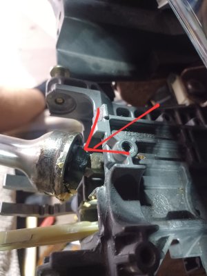

My upper actuator lost its pin. I ended up putting it back in and reusing it. I found my pin in this compartment:
Hard to see here, but there's a slot between that compartment and the one to right where the lower actuator slides up and down. That slot is for the steering lock latch.
Which brings me to one observation: the pin popping out like this is distinctly more likely with steering wheel tilt in its center position (as mine usually is) because that way the pin is aligned with that slot. In the other tilt positions, the pin moves up or down respectively, away from the slot.
On the above picture, you can barely see the lower actuator because it's so deep in. But even fully up, in Accessory mode, it does not poke out of the metal housing; it becomes about flush with it. That's why inserting the upper actuator requires some sanding (see the two options I described earlier).
And that's also why I decided to reuse my existing part. The pin, once pushed back in, appeared to be seated firmly. If this happened again - hopefully not, no, never, please - then I think I'd remove the entire column and fix this outside of the car with a new part.
