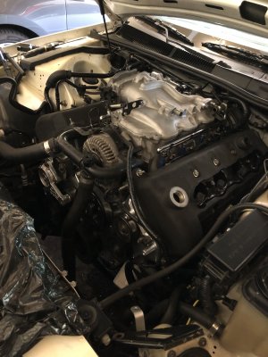

Ok, so just for those of us whose mechanical acumen never stretches beyond our (my) current project at hand, what exactly makes a cam killer?
I mean I can picture a cam shaft, I understand what it does, I know I only have one deep inside the V of my engine...but I don't know what makes one shaft better than the other shaft. Shaft shaft. Beautiful word. Talking about cam shafts.
Longer duration, slightly more valve lift and more overlap. That means more time and volume of air/fuel allowed into the cylinders and with the overlap (and soon headers) more scavenging… overlap means for a few degrees the intake and exhaust valves are open at the same time and the exhaust pulses actually help pull more air/fuel into the cylinder than otherwise possible with just the suction of the piston going down on the intake stroke.
It also sounds really cool idling, though I’m not sure what to expect with where I degreed them.
Killer in this context is high lift, high duration (,and high price,) lol.
Buying cams for a 4v hurts. Which is why we hunt cobra cams.
Want to buy my Cobra cams to slightly offset the pain I’ve endured?
