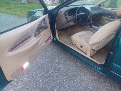

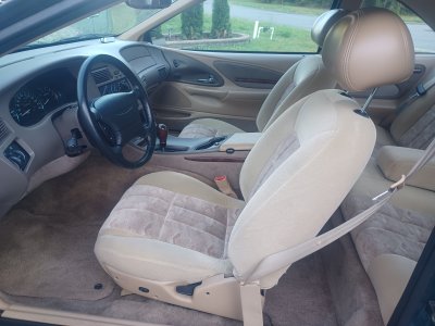

That’s like when I got my ACC carpet, the black carpet I had in it before was from a smoker car and the rubber backer was crumbling apart from dry rot. I got it as clean as it ever could get and black carpet hides many sins but it still had a mustiness I eventually went noseblind to. Putting the ACC in its place practically gave it new car smell

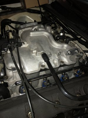

It doesn’t look like it but I got a LOT done this afternoon since I last worked on it.

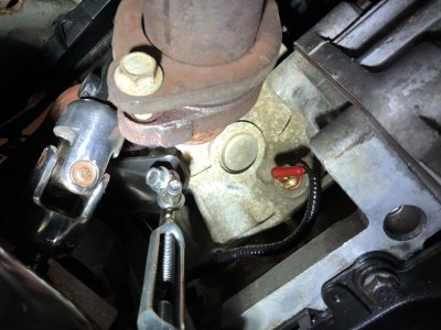

First and least interesting to anyone a new coolant gauge sender and pigtail(I had previously used a 2 wire 96+ sender which had been causing some problems for me and I had to add an unsightly ground wire I just looped around an inspection plate bolt.

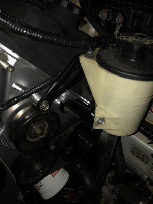

FINALLY painted my custom power steering reservoir brackets. Ones a modified COP bracket from a gen 2 Mark, the lower bracket I made from some aluminum flat stock
Got all my pulleys back on, they were all loose and just kind of set in place for the last photo, also bought a new belt today since the old gatorback was definitely done.

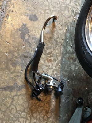

EGR now fully deleted. It’s not really a brag as I like what EGR does and this tube is MINT, but I do like how removing just those three components from the intake makes it look I can actually see the back of the fuel rails now! I even put the cap that didn’t fit me headers on the manifold… I’m doing the Kooks like next week but why not?(plus I’d like to see if I can shake down any potential idle issues in the tune in the evenings this week…. And I miss driving it)
Other than that I changed the oil, initially discouraged by all the water that was gushing out but then remembered I took the water pump off with the timing cover off… “oh yeah” 😆
after that I finally summoned the courage to spin it over with the starter and plugs still out to build oil pressure(I actually wanted to do that before I put the valve covers on but that want got obliterated by progress inertia). When I first started spinning it it was all clickity clack as I painstakingly bled all 32 lash adjusters but after about 10 seconds of spinning it went silent. So either all of the followers fell off or it built good oil pressure (I’m always paranoid by what I don’t see with my own eyes lol).
Gonna keep going on it, plugs, coils etc and get the base tune in. If it’s not too late I’ll probably fire it up tonight

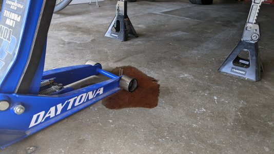

What's the prob with the pump?
It leaks like a sieve!
Well, not the pump itself, but rather the seal is broken so it leaks from there.
This is the day I brought my T-Bird into my garage. I added 4qts of ATF so it could move under its own power. Literally, all I did, was take it for a single 10mph lap around the block and backed it into my garage. Once parked, I lifted it. Not even 10min had passed from when I parked my car to when I took this picture and this is what was under the car.
