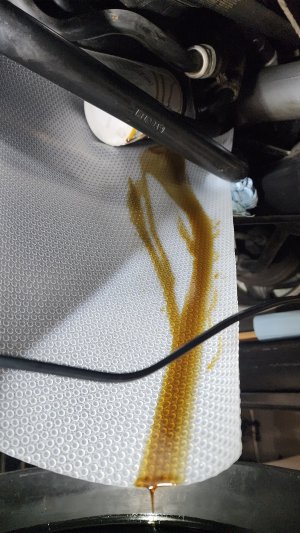

Changed the oil in my 92 and 35th SCs today. It had been 2 yrs & 15xx miles for the 92 and 3 yrs & about 150 miles for the 35th. This was the 1st time I kept all of the oil out k-member....I used some shelf liner and it worked greatView attachment 12268

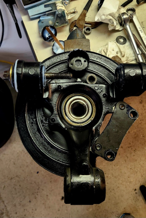

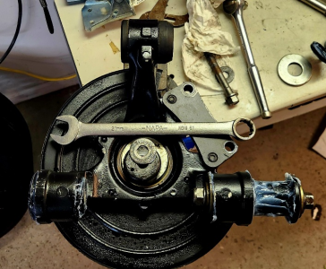

New bearings/hubs and Energy Suspension bushings. One old bearing race was a bear to get out so a flame wrench and water were in order. I used Harbor freight hole saw for the win to bring everything in. The CVSource guy is well versed on everything CV joint related and did a great job on the rebuilding of the RAxles, they really needed it after taking a pounding after all these years. I also ordered a Powershift Factory rear diff mount for the party as well.
