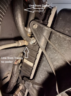

I made a simple frame out of aluminum bar to mount the cooler to the rad frame and tapped into the radiator tranny lines. The oil is flowing through the cooler then the radiator for extra cooling. It is suggested to add a tranny filter in line with the tranny cooler back to the rad. I opted out of that since I don't have a race car.A couple of people mentioned oil coolers above; What you need is a transmission fluid cooler bigger is better.

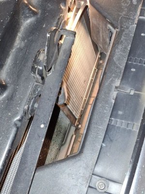

I'm using the biggest one they make, 48kbtu I think.It's mounted in the front of the radiator and ac stuff. I didn't use a cold weather bypass, but depending on where you are, you may need to.

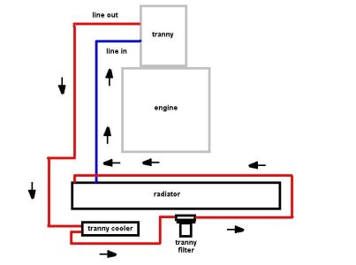

Seriously, do what you have read or think would be best. I do not recall where I got the layout from, but it has been there for some 17 years and no issues. In thinking about this, my thought was, send the hottest fluid through the smaller, opened radiator to cool down faster first, then into the rad where it is not cooled as fast. My two cents. Hope that helps.Ok...very useful post! But...
On my car, the top coupling on the radiator is the exit. Unless, yours is different, based on your photo, it would be: tranny > radiator > supplemental cooler > tranny. This is also the setup that is generally recommended from what I've been reading.
However, your diagram shows: tranny > supplemental cooler > radiator > tranny.

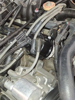

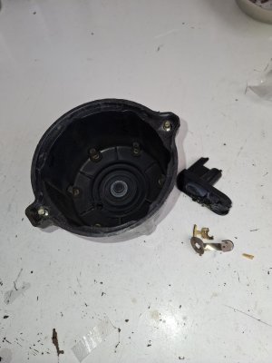

Last night, I pulled my IAC and was going to replace it with my OEM one that I pulled from the yard because I have had consistant low idle for some time now. That is one indication of a IAC going bad. After reaplacing the IAC, the car started to run like crap. I put the first IAC back in, then the car would not start. I said "F-it" and went to bed. I figured I flooded the thing. This morning, I try to start the car, no spark. Hmmm.... I put my test light on the coil to cap and got spark. I put the light to #1 plug and NO SPARK! WTF? I pull the cap off and the rotor blew up! Weirdest damg thing I have ever seen. I had a new rotor and cap (2nd pic) in my spare parts box I bought when they were on close-out at RockAuto.What I did to my Cougar today (sounds like writing my weekly report to DOGE)

Ahhhh.... now i see what you are saying. I believe you are correct. I used the top one cause I did not want to have to try and run my line under the car or radiator and if I recall, could not find an easy space to do so? I will have to look more into this and see if I have this all bass ackwards.I hear your rationale. That's a different subject.
My point was: I don't think that's what you actually did based on your photo. It shows the supplemental cooler between the radiator top coupling and the transmission. On my car, that's fluid exiting the radiator. And I can't imagine they changed that over the years; but I'm happy to be persuaded another way.
On the subject of which routing is better, i.e., which cooler should come first, the rationale I read most frequently was to go radiator > supplemental cooler. Reason being that a cooler can only cool the flow-through ATF to the temperature of the surrounding air/fluid. Assuming that the coolant in the radiator, even on the coolant exit side, is still hotter than ambient air, the radiator can cool the ATF to no lower than the coolant. Then the supplemental cooler can cool the ATF to no lower than ambient air.
(Evidently in practice, neither cooler cools the ATF that much; I'm just talking in principle.)
