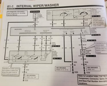

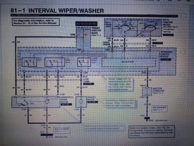

So far, what I think I determined is that the connector on the Mark motor has seven wires vs. only six on the Bird.
I have the diagrams for MN12. Could anyone provide me with the wiring diagrams for the Mark VIII? Any year should do. Otherwise the diagrams for any Ford with that type of wiper motor, e.g., 90s Panthers.

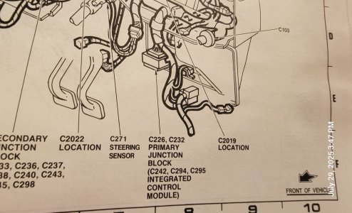

Looking at the Bird's diagram, I understand this is all driven by the "Integrated Control Module". Chances are I would need to swap that, too.
The module is part of the wiper motor assembly.

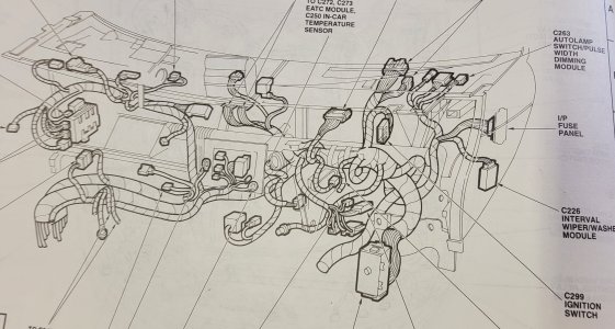

I have the Mark diagrams at home if nobody else posts them before I get there.
I was mistaken; the Tbird "module" is integrated into the dash fuse block.
Here's the Mark diagram and module location .. if you had the Mark wiper motor and module with pigtails; it would just be a matter of re-wiring some of the original wires at the fuse block and adding a couple extra wires for the park sensor.
