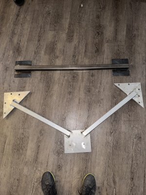

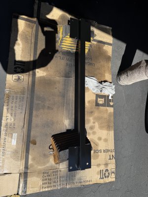

Today I got back the aluminum V brace my buddy was making for me. This thing is wayyyyy lighter than the steel one haha
my only problem now is the lower bracket where the V bolts too came apart. The spot weld ripped up, sucks ass. I was thinking of either hitting up my buddy to weld it back up orrr maybe try one of those epoxies. I seen 3m dp420 is a really strong epoxy which I’m hoping should be enough to hold it in place of welding.

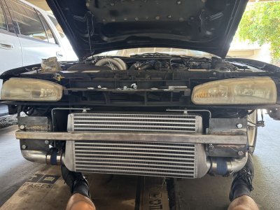

I also got the bumper reinforcement done since I had removed the stock piece in order to install the intercooler. My question is, since it was spot welded on should I weld this bar back on or can I get away with bolting it in place??
I'm having a hard time imagining what you need to weld/epoxy, but I don't know if I would trust an epoxy adhesive in the place of a weld.
Does the bumper reinforcement just span the frame rails side to side? I don't think I'd have any problem bolting that in place.
@KevinVarnes
I’m talking about this lower section, where the V bolts up too. The piece of metal ripped the spot welds off and I just put sheet metal screws in the mean time. I’ve heard great things of that 3m epoxy, and from the promo video it’s very strong. But like you say, can’t beat an actual weld.
Yea it only spans from frame rail to rail. I just don’t wanna go through the hassle of drilling out the holes on the bar plates when welding it in place would be better.

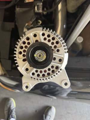

Also I juuuuust replaced the alternator, removed the old one and it had some small pieces of metal falling out….. I guess it don’t like the new 6500rpm redline 😬
They use a lot of epoxies to bond panels together these days, so I'm sure it is good stuff. I'd be willing to bet it isn't cheap.
I think welding or bolting that cross brace would work just fine. Whichever is easiest/more convenient for you.
Got a chance today to throw on the bumber bar, bolted on as best I could. It definitely helps with the rigidity of the car, it’s not as loose up front.

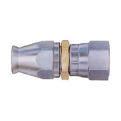

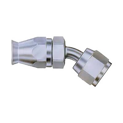

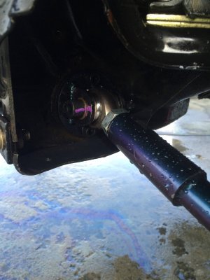

Aaaallllsssoooooo, the stupid braided pressure side power steering hose ripped 😤 gonna have to get the OEM style for now to get me around.
*edit* it seems like the fitting ends are reusable?? Is it really as easy as buying the hose and installing these same ends??
@XR7-4.6 perfect I had asked my buddy and he was talking about getting new crush olives but I don’t think these have that.

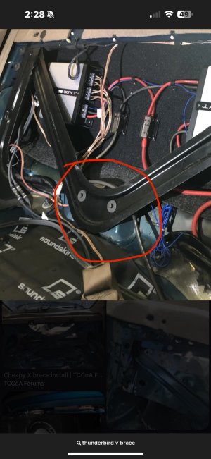

That's a HUGE AC Condenser you got there! :LOL: ... BTW who's trunk is that in the V-brace photo?
@Trunk Monkey I’m not sure i found in Google, to highlight the bottom piece that ripped the spot welds off and needs to be rewelded orrrr epoxied on.
Thanks. I was joking. I knew exactly who that car belongs to. :thumbsup:
Not sure where it was posted but that's a picture that I took of my car and my trunk when I was installing my stereo system.

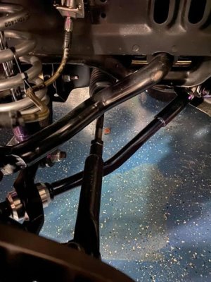

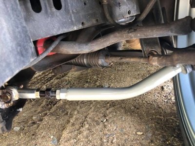

Yea definitely I don’t like that bend either when trying to make a whole new rod, maybe if you added a plate on top on the bend side but that would take away space from the tie rods. I did see Stephen’s style where he just sleeved the stock arm and put the heim at the end. IMG_7871.jpegIMG_7867.jpegIMG_7874.jpeg
Sleeping the stock strut rod would be the best way, the one on the bottom, is the one that comes to mind I don’t trust

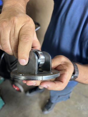

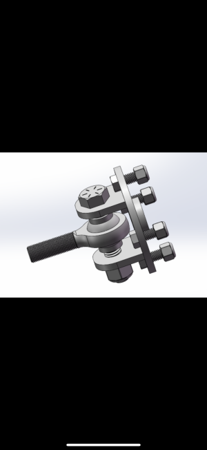

Also, grab a 2nd strut rod at the JY yesterday. Along with some 3/4” heim joints and 11/4” chromoly tube. If all goes well the fabricator will have the heim strut rods soon. I’m really over the stock weak ass bushing.

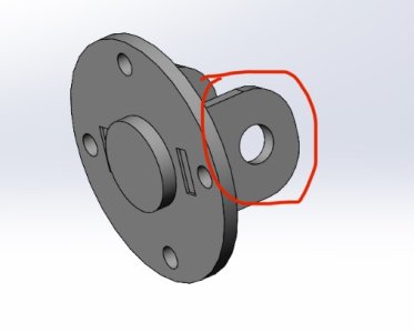

The fabricator sent me a drawing of the mounting point for the heims. Looks pretty sweet, since he has a CNC machine, thats how he’s gonna cut it out.
Hopefully Saturday he has time to knock it out. I’m hoping the install should go fairly easy since I’ll be cutting out the old rods instead of disassembling everything. If all goes well I should have another set of rods that will also get modified if anybody is interested.

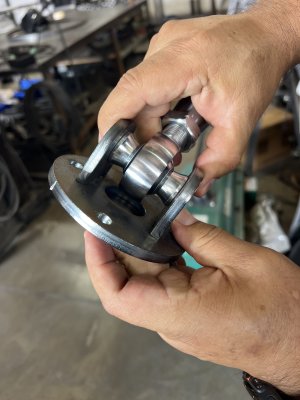

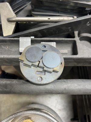

My buddy got the metal all cut out today, the tabs have slots where they will slide into and he cut the locating circle where it’ll slide into the frame holes from the original bushings. He also cut another circle that’s gonna sandwich the rear side of the frame together with the front mounting bracket. All 1/4” I doubt it’ll ever break 😅
Pretty pumped to get rid of the bushing already. Another buddy who has a 300zx has heim jointed strut rods aswell and his steering feels SO direct. It does have more road feel to it but it’s a trade off in willing to take.
How do these mount to the K-Member though? Like, I see where it's supposed to mount, but I'm not sure on the how.

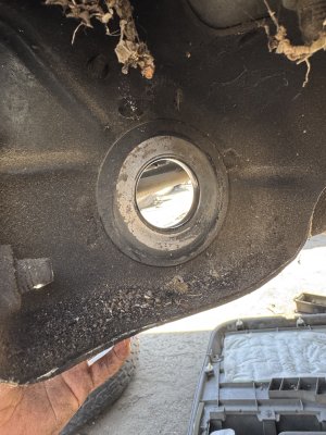

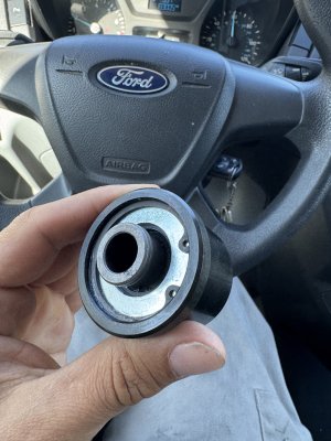

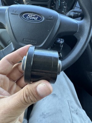

Picked up the final piece to the puzzle, Johnny joint for the control arm/frame side of the frame.
Completely rebuildable and much better articulation than the stock bushing. This in combination with the strut rod heims should totally transform the handling up front.
This is a mono ball with two urethane bushing sandwich up against it inside

Can this design be made to fit the rear UCA location? If so, you'll have a decent amount of buyers!
@CDsDontBurn unfortunately not, these don’t not have the eccentric (I think that’s the name) bolt hole that is needed to adjust the camber in the rear.
Would have been cool tho haha, I wonder where SCP gets that one from for their tubular piece.
