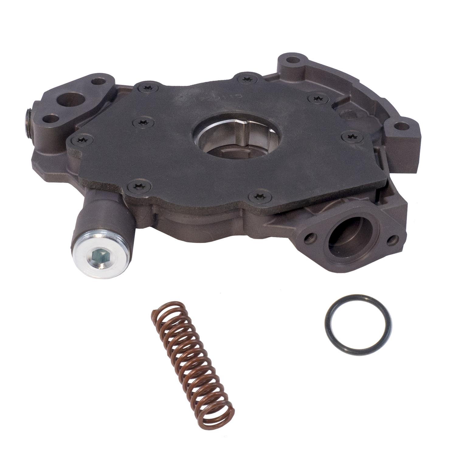

Be very careful on oil pumps. A lot of Melling ones in particular out there that seem inexpensive aren’t actually mellings but Chinese knock offs with their logos like you see with “cheap”Walbro fuel pumps. The real deal ones aren’t terribly expensive but they’re not necessarily cheap either, you should always source them from a trusted vendor which isn’t necessarily the best value. Plus if you’re spinning or planning to spin to 7500+ you should probably seek out billet oil pump gears which are most definitely not cheap, but at that level pretty necessary as the cast stock and Melling ones can shatter with the high rpm harmonics(once again, balance the rotating assembly!)

I have my eye on this pump by melling, supposedly it has hardened gears and flows more than stock.

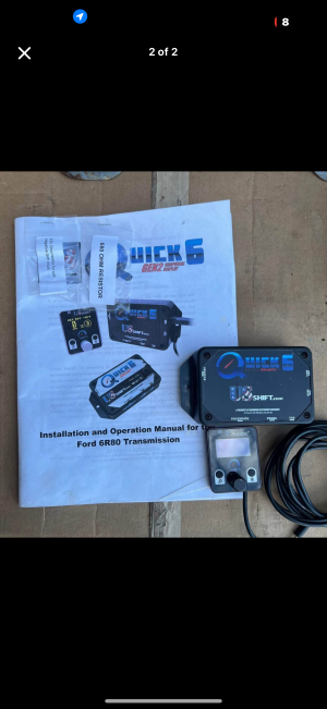

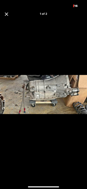

Also I ended up getting the 6R swap from the FB guy, paid $1500 for everything. I just need a matching flexplate and driveshaft at this point. The shaft will get figured out once it’s bolted together. IMG_8460.pngIMG_8465.png

Also I ended up getting the 6R swap from the FB guy, paid $1500 for everything. I just need a matching flexplate and driveshaft at this point. The shaft will get figured out once it’s bolted together. View attachment 14799View attachment 14800
If you’re staying 2V don’t get the High Volume pump, you’re just pushing more oil into the heads without any benefit, plus you’ll need to source a specific high volume pickup tube to work with your pan (96-98 mark VIII)
@XR7-4.6 really?? I’ve read is necessary when boosting to keep the bearing happy. I do plan on grabbing a mark 8 pan and pick up for the added quart capacity.
Mark VIII pan is good, oil capacity is what you want. Volume? If you’re concerned about bearings you should see what happens to them when a high volume pump sucks the pan dry!
It really makes zero difference between NA or boosted beyond the centrifugals having an oil line to them, which is a teeny tiny pressure bleed compared to the 4Vs 16 extra lash adjusters from the 2V the HO pumps were designed for. And even then that only came about deep into the 4Vs production, the 2V and 4V actually shared the same pump from 93-95 and some engine builders to this day actually prefer using the 2V pump on 4Vs since they are less prone to flooding the heads at high RPM and sucking a tiny bit of extra power to run them. Both pumps are putting out more than 100PSI above 2000RPM at full operating temps which is more than enough for engine longevity, whether or not there’s boost involved.

@XR7-4.6 im gonna have to look into it further and consult Todd Warren over on the FB engine builder forum. Great guy and a fountain of knowledge. What pump are you running on yours?? And def will be getting the mark oil pan and pick up.
I’ll certainly defer to Todd, he guided me to where I should degree both my latest comp cams as well as my 98 Cobra cams when I first put those in several years back.
Now IF he like me doesn’t recommend a HV pump for a 2V application and to stick with a SOHC pump you won’t actually need the mark pickup even if you get the mark pan. The Mark pan has the pickup in exactly the same place as the Tbird pan, it’s extra quart of capacity strictly comes from the tumor sprouted off of it sideways under the starter.
… also be aware of you do use a HO pump only 96-98 marks used those and the larger diameter pickup. 93-95 use the same pickup as tbirds but still used the larger 6 quart pan.
As for my setup I’m running a NOS 2014 GT500 pump… I know do as I say not as I do 😆 main reason being though the GT500 pump uniquely has a billet back plate vs the cast ones the regular pumps as well as Melling use. I’m too frugal for billet gears so that was my compromise, plus it’s a 4V like the GT500

@XR7-4.6 ohh I didn’t know that I thought all marks had the bigger pick up tube, good to know I would of been hating if I got the earlier version just to find out it’s the same as my bird haha. Main reason I’d go with that Melling one is because it has the hardened gears which I’m assuming is better than the cheapy cast ones, what are you revving your 4v to?? Is your intake ported?? If not you should really consider that since the 4v loves to rev.

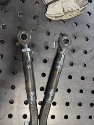

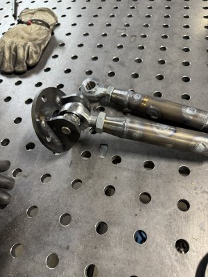

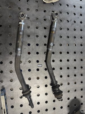

Also also side note, my buddy got the strut rod’s done already, and they look and feel great. I was really looking forward to throwing these on the bird but unfortunately the engine had other plans 😬 I’ll keep you guys posted when they get installed and post a review.
View attachment 14805View attachment 14806View attachment 14807
Those look sexy, hope they work as well as they look!
@Zep5.0 i hope so too, FB guys who have done this don’t have any complaints so I should be good 🤔

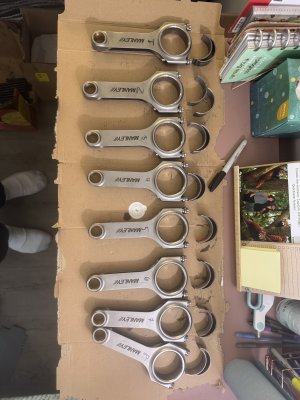

Been a while but I’m finally getting the 4.6 back together. Got the 98’ cobra block .020 over and ordered parts to rebuild it.

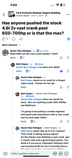

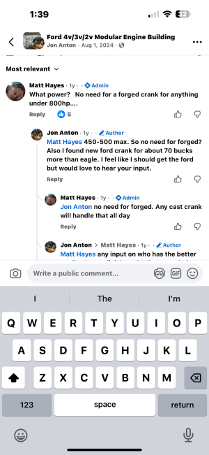

Unfortunately the cobra crank was no good and I couldn’t afford some forged pistons. Went with a cast crank (which is pretty strong, handles good RPM and power according to Matt Hayes over in a Facebook 4.6 group) Manley H beam rods and some mahle hyper pistons. Sucks but it is what it is. Not planning on making over 450whp….. maybe haha stock cams I doubt it’ll make much over unless I switch to the edlebrock intake and rev it a bit higher.
ARP main and head studs also.
