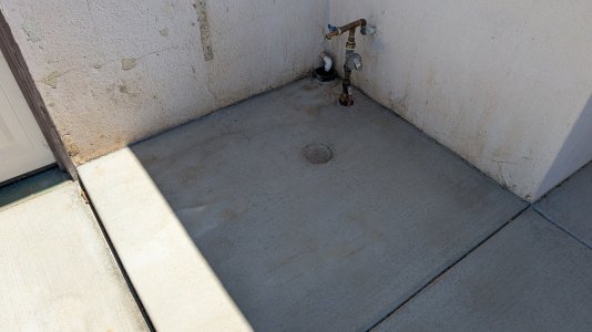

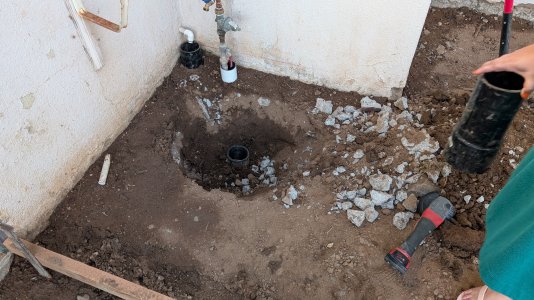

So the next saga in my DIY adventures is revisiting that AC drip line. If you remember, it was originally going into the sewer clean out, but because it's not code, I had it to remove it and dig a circular hole.
Well, while it was right to do it that way, I'm guessing it's not deep enough of a hole because when the AC is running for an extended period of time, that drain hole overfills and begins to get the concrete wet.
My wife is wanting to bring up the drain pipe to a higher elevation and have it dump the water into a planter that would get installed there at the new location. Another idea she has is to install new plumbing and have it drain to the opposite wall of the existing wall and drain there instead. A third idea she has is to install an AC drip pump or whatever it's called and run that to wherever we want.
All these ideas are great and all, but they require a whole shit ton of work I'm not willing to do because I already have a shit ton of other house related work to do right now. I don't want more work to do when I already have a shit ton of work to do.
My idea. My idea is to just cut the hole where the current drain hole is at and make it a little bit wider and deeper. Currently it's just a 4" diameter ABS pipe going about 12" down. I'm thinking of just having it be a 6" x 6" square hole and digging the dirt out deeper, at least 18" or even 24". I have a sawzall and see that concrete sawzall blades exist for $30-ish. I imagine doing this work would only take about an hour to do and I'm on my way to the next thing that is actually on my list.
My wife doesn't like this idea of mine because it's too close to the foundation and we won't be able to get a hole deep enough for it to do what it's supposed to do, etc., etc. She's goes on to say that even if we did get the hole deep enough, that it would just make the soil beneath weak and compromised over time. Knowing that this is a common solution, I don't believe that is true.

Dry well should be at least 3 feet deep minimum. Also helps if you fill the bottom 6 inches of the hole with gravel / rock. Holes / perforations in the bottom foot of the drain pipe so it disperses water outside instead the pipe of just down the bottom. A French drain would be another method to spread water over a larger distance.

I don't see concrete in the picture???
You don't have a basement, so I'd just dig a 3' deep by 18" hole and fill it with rock.

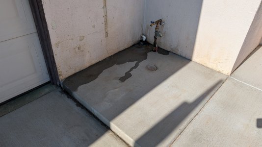

Current picture of the affected area. Concrete was poured a month ago, and the issue didn't present itself to us until late last week.
You can kind of make out the witness marks of the water going towards the left up against the wall.
Is there any way you can get a long auger drill bit to simply dig the hole down deeper ??
I could potentially do that, yes.
The limitation here would be the tight spacing constraints of it being in the corner. That, and the foundation of the house, the cement spreads out away about 2in. or so.
Walking out the house right now, and this is what it's like.
4" diameter x 12" depth = 150.72 cubic inches = ~.64 gallons
Clearly that's not enough space for the water to get absorbed by the ground
What overflowed looks at best 2x that so the best/easiest solution is dig that shit out. Doesn't need to be straight down, either. Just needs to make room for the water to get absorbed. If you are worried about a sinkhole, add some rocks in the hole after digging.
I will see what I can do to dig this thing out deeper.

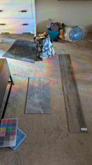

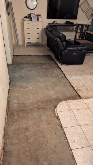

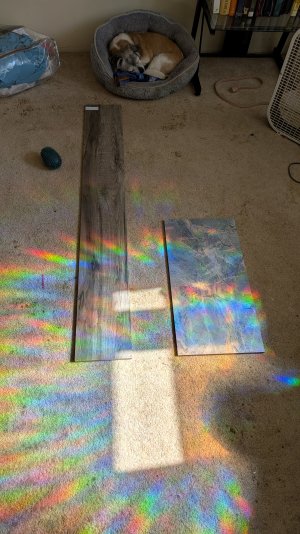

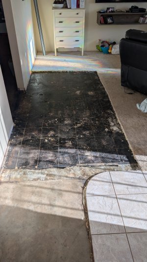

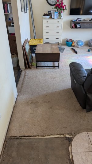

Demo continued today for a bit of my floor. We've now expended two 1gal bottles of paint stripper stuff for the black mastic.
We're also like 99% sure we're going to go with this long plank style tile as our flooring option.

It looks like pressed wood, but it's not.
These planks are tile! 😁
Nice choice! That's what I have in most of my house, it looks really good.
