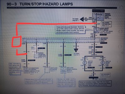

If you only interrupt the brake on/off switch signal to the ECM, I don’t think it would throw any codes or cause any limp mode. But you would have to interrupt it only going to the ECM, otherwise your brake lights would be on all the time. Interrupting the TCC signal wire from the ECM to the trans definitely would cause codes, and likely limp mode.
Yes, understood about the brake lights.
But does the PCM do anything  else with that information? I mean, I would be simultaneously on the throttle and on the brakes (not actually on the brakes, but the PCM would think I am). Would the PCM change any behavior other than TCC not locking up?

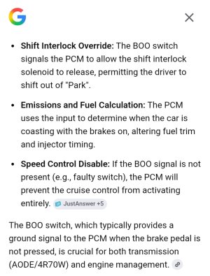

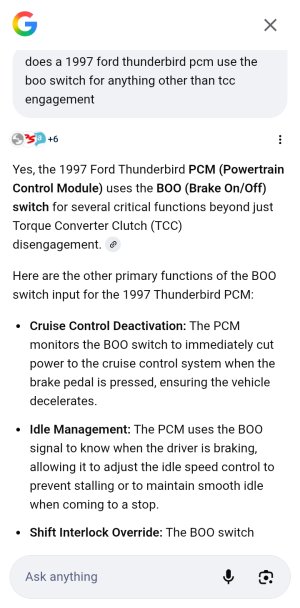

In our cars, we only have the VSS, which is the gear driven one. Later cars use the OSS, which is the magnetic pickup. And some later 4r70s use both. But for your purposes, the ECM interprets OSS based on VSS signal. As for other things the ECM depends on brake input for, I don’t know off the top of my head, but I doubt it would be anything that would affect drivability. A quick test would be to put your left foot just barely on the brake enough to turn the lights on and drive it and see what happens.

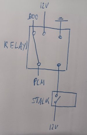

Here is the basic diagram:
The red box is RELAY 1 in the drawings below.

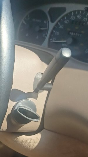

Now, to understand the drawings below, remember that I have a small 4-way stalk on the right of my steering column (a repurposed Mercedes cruise switch); currently its only function is for O/D off.
This 4-way switch consists of three normally open and one normally closed switch.

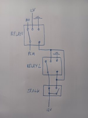

Option 1
For the purpose of this drawing, the box marked "STALK" utilizes one normally open and the normally closed switch.
RELAY 2 is wired to be a latching relay. That means that, if I disable the TCC using this setup, it won't lock up until I reactivate it.
If I went with this, I think I'd want to have a light akin to the O/D OFF light to illuminate when the TCC is disabled.
