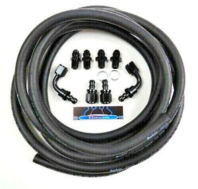

What do you guys think of this kit? Pretty cheap, it does use cheapy oil lines but it should be good enough.

Yea this kit is all rubber hose front to back, why is only rubber a bad idea?? I currently have a Hayden cooler also fitted to cut metal trans lines. It does work fine but just wanted, was thinking of upgrading to the trucool 40k cooler .Define cheap? My Hayden cooler cost half that and that was all I ever spent on a trans cooler. The lines were from the parts store and probably cost under $10, spliced into the stock hardlines. What you do not want are rubber lines all the way from the transmission to the cooler and back, which it seems like that kit does.

I hate to say this, but shop around some more. I am not at my PC, so I can't share my pics of when I did mine, but I know I did not pay that much for my kit. That is hoses, etc. I did have to buy separate brass fittings for the engine rad, the kit fittings where not the same thread. I think I did a write up too.Define cheap? My Hayden cooler cost half that and that was all I ever spent on a trans cooler. The lines were from the parts store and probably cost under $10, spliced into the stock hardlines. What you do not want are rubber lines all the way from the transmission to the cooler and back, which it seems like that kit does.

That’s a problem that I have, I have no idea what threads or size fittings it would need so a kit like that makes it easier for dummies like me.The big problem with all metal lines, is coming out of the side of the trans. To come out with a 3/8" line, it won't bend that far without kinking. The threads in the side of the trans are BPST(British pipe straight threads) I bought an adapter, bpst to npt, screwed a full flow 90 on that,and screwed my NPT lines into the 90. The hole in the trans is smaller than 1/4"npt, imho.
