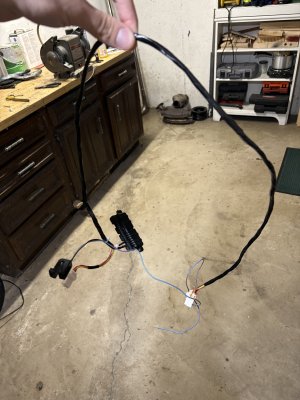

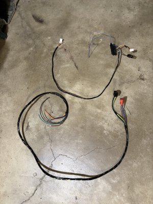

Alright blend door (and illumination)harness done
The big black connector will actually plug into the SATC connectors… it’s actually salvaged off of a dead SATC head… I was hoping to get more outputs from it but as it turns out of the 48 pins in it you only actually need 2! Ignition power and ground. The temperature knob has 3 wires and is wired straight to the blend door, the power and ground powers the blend door actuator (it basically functions like gauges). Only other useful thing in the harness is illumination, you can’t use SATCs illumination wire(LG) as it is not 12v, that needs to be sourced from elsewhere(stay tuned), ground however I shared with the blend door pin.

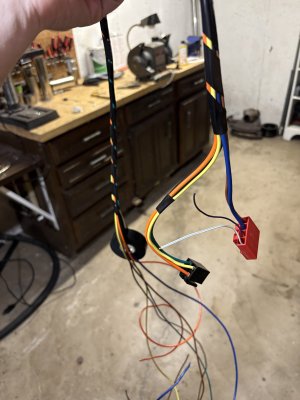

This wiring is for the blower motor/speed control 6 wires total, and I even color coordinated them!
Brown is source power, wire is 12 gauge, which will be taken from the dash connector that goes to the PWM which will now to the function selector switch, from the function selector switch will be the blue wire(also 12 gauge) and it will run to the blower motor connector. From the blower motor connector is the orange wire(again 12 gauge) which will run both to the resistor block and fan speed knob. Black as you might guess is ground and yellow and green are the middle two speeds between the resistor and switch, these all step down to 14 gauge as per factory spec
The bulk of the work is done with these I just need to cut the blower speed harness to length and solder its source and resistor connectors on. Nice and tidy so far.
